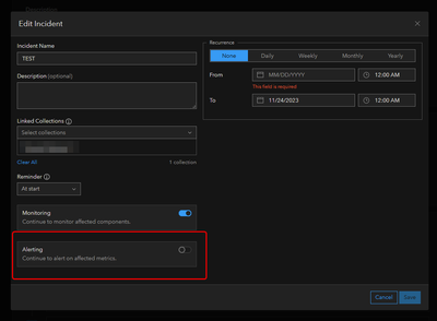

GeoJosh
Hi Fraser. There's two scenarios that could cause this:
  • None of the metrics associated with the component have alerting enabled. The solution would be to enable alerting and set alert thresholds as needed on at least one associated metric.
  • There's an active incident that encompasses the components that is suppressing alerting. The solution would be to go to Administration > Incidents, find the offending incident, and enable "Alerting".GeoJosh_0-1701352888863.png
Josh
