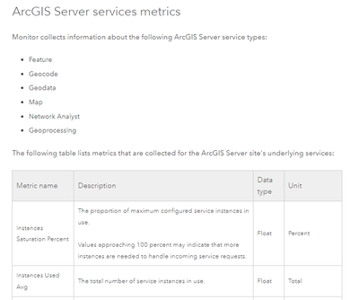

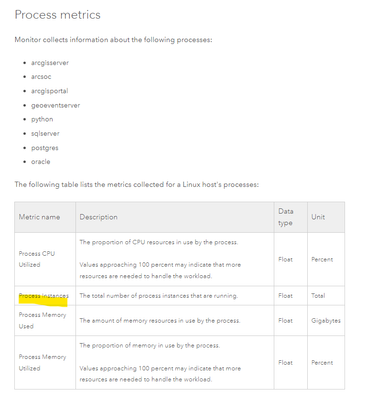

@NaveenK , to add to @DerekLaw , note the difference between
Metrics reference—ArcGIS Monitor | Documentation
Process instances, which is the number of arcsoc.exe running at the collection time (e.g. every 1 min):
and
ArcGIS Service Instances used, which is an average over collection interval, e.g. 5 min.
It is expected these numbers will be different.
