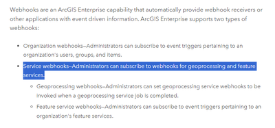

Hello @GeoJosh ,
Thank you Josh! The solution you provided requires the use of a webhook right? I see in the help documentation that webhook supports geoprocessing and feature services, other service types are not supported. Thank you!

GeoJosh
@Lerman, Thank you for clarifying.
Enterprise webhooks are different from ArcGIS Monitor webhooks. Webhooks in ArcGIS Monitor are one of two ways a notification can be delivered (the other being via e-mail). Notifications can be set on a variety of different resources in Monitor, including registered components and metrics. This means webhook notifications in ArcGIS Monitor are not limited to specific service types. A webhook payload will be emitted whenever the notification rules you define are triggered.
Please see this documentation for more on notifications and this documentation for more on the webhook payloads that ArcGIS Monitor emits.
