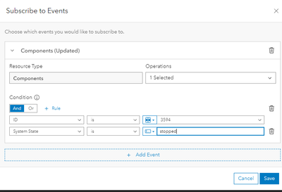

ArcGIS Monitor does not count these requests as failed requests, so the current version of arcgis monitor cannot generate alerts, right? There is no other solution in the current version, right?
You can be notified via e-mail and webhook when a service is stopped by creating a new custom notification with the following configuration:
  • For "Operations", choose "Updated"
  • For ID, specify the ID of the service component.

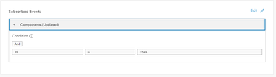

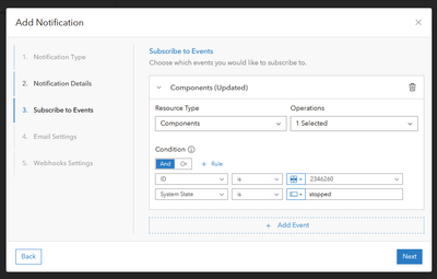

IrisHadarStltd
Hi ,
I tried to create the NOTIFICATION as you explained, but after saving, the system omits the condition of System state is stopped
PatrickKielty
Did you ever find a solution to this issue? I am trying to do the exact same thing and the 'stopped' rules is gone after I click save. Also, not sure why we have to type the value into the value box when it should be populated. Thanks

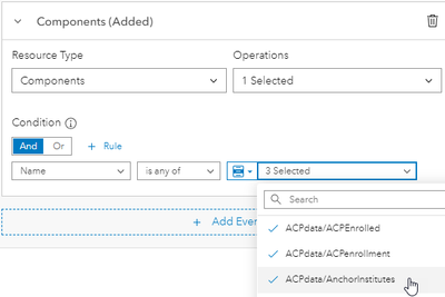

PhilLarkin1
Are you on Monitor 2023.3?
You could try to set a condition based on Name + Contains + selection of service names. Or ID + Is Any Of + IDs you need.
ChrisRobinsonCOF

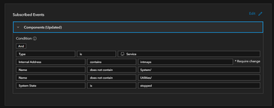

Thank you Phil for the idea.  Yes, I am on monitor 2023.3.1. That does seem to work for me but I have a few servers registered that have the same folder structure and map service name. If I stop a service on one server that has a duplicate name and folder structure from another, a notification doesn't get generated. If they are duplicated, the drop down list doesn't seem to recognize those duplicates by server so I am looking for a way to create a notification by server.  I came up with this definition below, the logic seems sound but I am not getting a notification result if I stop a service:
Thank you,
Chris
PhilLarkin1
I've not used Internal Address. Curious if it is actually want you want to target. The description of that component is 'The common network address.'
