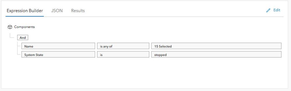

As a temporary solution, I’m using Collections to monitor whether a service is Started or Stopped. Collections allow monitoring of System State, which reflects service status. I created multiple collections based on projects with multiple services. In Expression Builder, I select all relevant services and set the System State to STOPPED (or STARTED). Then, I configure notifications to alert based on Updates.
In short:
  1. Create a collection based on services that are up/down.
  2. Set it to check every minute.
  3. Enable notifications for changes in collection status.
  4. Rename the notification email to “ArcGIS Monitor Service STOPPED” to include a table with the affected service name.
This method ensures alerts trigger when services start or stop, providing proactive monitoringservice stopped.jpg
