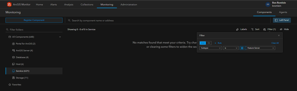

The interface has a filtering option for Feature Server subtypes that returned no components:
This and the delay between requests to the service being sent and being displayed in monitor made me think it was only logging requests to the Map Server URL.
But it looks like the component is properly logging requests to the service whether the connection is through the Feature Server or the Map Server URL.
