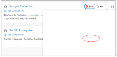

Should clicking the Collection status load a dialog or launch to another screen? It looks as though something is about to happen, however it just hangs.

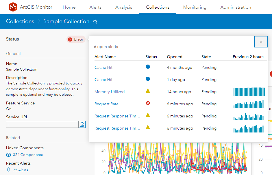

Clicking the Collection status icon should display a pop-up that shows alerts for the collection. Something like this:
Perhaps try re-loading the ArcGIS Monitor web app in your browser? Maybe clear the browser cache to help resolve the behavior you're seeing?

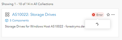

I have confirmed the same issue is happening on my server as well. Cleared cache and started in inPrivate window:
René_Ténière
I am going to log another bug with Esri Canada on this. Also having issues with Apply Labels whereby selecting multiple items and clicking Apply Labels and selecting a label causes the website to freeze up.
