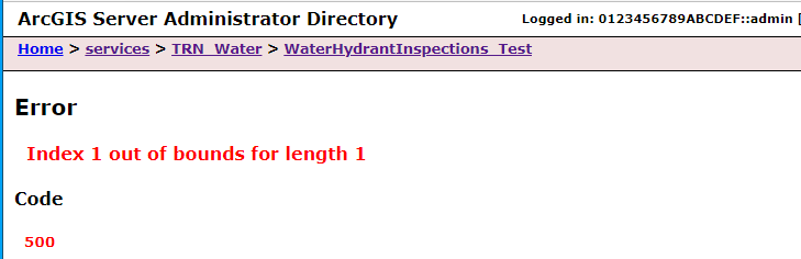

Am using ArcGIS Monitor 2023.1 with Enterprise 10.9.1.  There are a couple of mapservices that no longer exist (deleted and when trying to paste the mapservice REST URL from ArcGIS Monitor got error 500) in ArcGIS Server (federated) and yet ArcGIS Monitor is showing the mapservice as Error.
I tried restarting ArcGIS Monitor service and it did not change anything.
Past the URL reported from ArcGIS Monitor to browser and got error 500 :
This is in Monitor Components reporting an error for this mapservice:

Hi Anthea,
This issue is addressed in ArcGIS Monitor 2023.2 (see BUG-000157190 in the release notes. Please upgrade to this version at your earliest convenience.
Josh

@GeoJosh  thanks for letting me know.  I upgraded to ArcGIS Monitor 2023.2 and it works good now.
