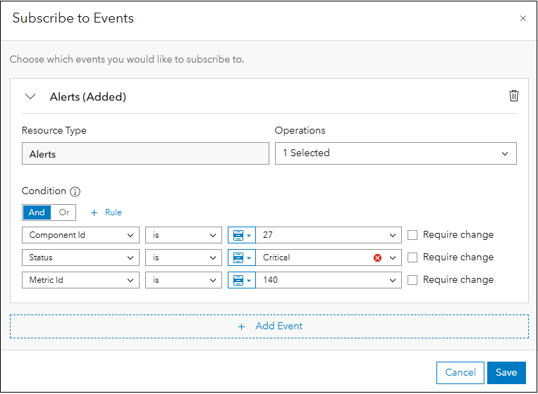

Our organization has configured our notifications to be triggered upon a critical or warning alert being created, but is there a way to filter them down further to only trigger when a critical/warning alert for Response Time Avg or Max is created? Is there the ability to filter the alerts by alert type or even by component name? I only see the option by ID, which is a bit confusing and not intuitive. Thanks so much for your help!

Hi @HenriettaK,
Yes this is possible. When you create a notification, you can also specify the metric ID for the metric where you want to set the notification on.
For example, in the screenshot above: Component ID refers to the ArcGIS Server component that you want to watch for any critical alerts and Metric ID refers to the Response Time Avg metric of the ArcGIS Server component.
We use component IDs and metric IDs so we can be very specific on which component and which metric we want to set the notification on. Sorry. Please submit a feature enhancement request.
