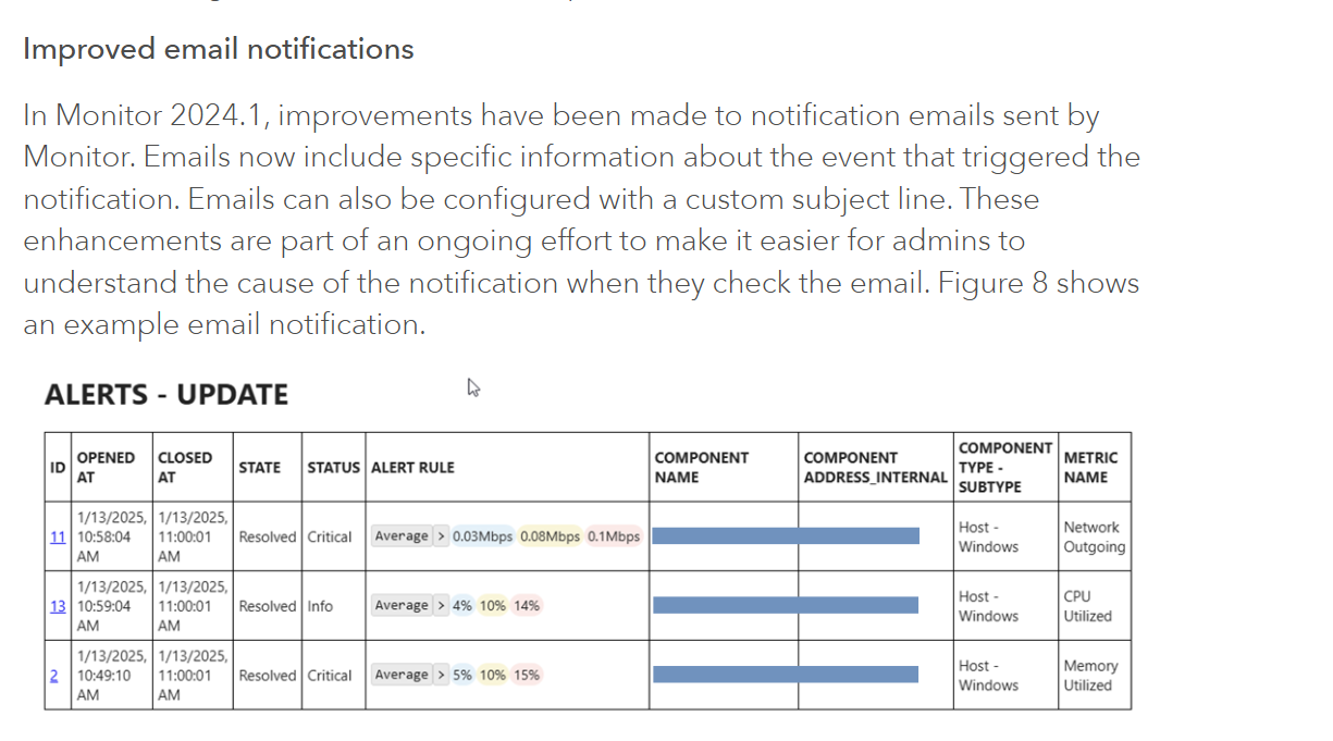

That's unfortunate, that's not what that blog post is showing or saying though. Very misleading. Is this functionality coming  though to get it show like the screenshot?

Hi @HannahSturm,
I'm not clear on what you're saying. The image you attached from the What’s New in ArcGIS Monitor 2024.1 blog is an actual screenshot of an email notification from Monitor. This was taken from one of our test machines.

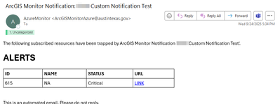

HannahSturm
Hi Derek,
Attached is what I'm currently being sent in email via the notifications from Monitor. Are you saying that we are not able to customize my screenshot to look like the screenshot that came from the test machine where it has the layer name, state, status, etc?

Hi @HannahSturm,
In your second screenshot, it looks like you've configured a notification on a component's metrics. So what you're seeing is expected. I suspect you need to configure your notification to trigger based on an alert becoming active, not on a component metric.

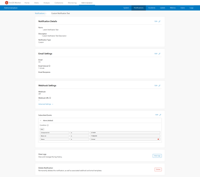

ChazArmijo
i'm trying to accomplish the same as @HannahSturm. i created a custom notification based on a specific alert and i'm still getting very little information in the email

Hi @ChazArmijo,
The notification configuration appears correct based on what I can see in the screenshot. What release of ArcGIS Monitor are you using?

DerekLaw
Esri Esteemed Contributor
Hi @ChazArmijo,
2024.0.0
You'll need to upgrade your ArcGIS Monitor instance to 2024.1 or higher. The notification email content enhancements (mentioned in the original post of this thread) were added in the Monitor 2024.1 release.
