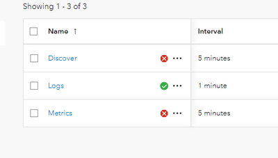

1. When I try and log in, I get: An error occurred running the observer   Undefined is not a function
2.  Interestingly, I can still see my Server logs, but I can't get metrics or discover to work

Dan_Brumm
That was it! I had 6 reports named with all numbers. Deleting them cleared up the error.
