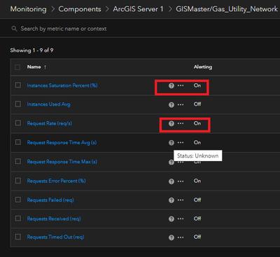

Hello Guys,
ArcGIS Server services status and its metrics status showing as 'Unknown' instead of Nominal despite alerting being set on certain metrics.
Toggling the alerting OFF/ON  puts the status back to 'Nominal'.  This may be a workaround but can't do this for all the services (and its metrics).

Would it be possible to attempt and restart the ArcGIS Monitor Server Service on the machine? It may be hung up with cached or invalid data that would put it into an unknown state.

@CodyPatterson - I did this multiple times but no luck

This might be related to a bug in the older component status model. Please upgrade to the latest ArcGIS Monitor 2023.3.1 release. Or if you can, wait for the ArcGIS Monitor 2024.0 release which will be coming out in later this month.

Hey @NaveenK , check if the connectivity observer is working fine for the site (in your case ArcGIS Server 1). I have observed that if there is an issue with the observer, the metrics is not collected for either the parent and the child component.
Click on Monitoring tab >> open settings for ArcGIS Server 1 >> Observers.  Does any of the connectivity observers have a red x mark next to it?

Hello @Shawn_NG - I don't see any red x mark to connectivity observers. However, when I checked the logs for these ones (Like discover, metric), it says run failed. So, looks like some issue with observers.
