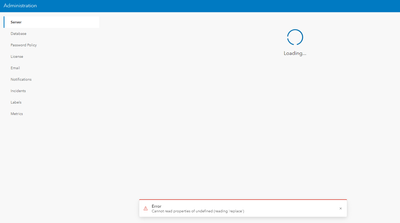

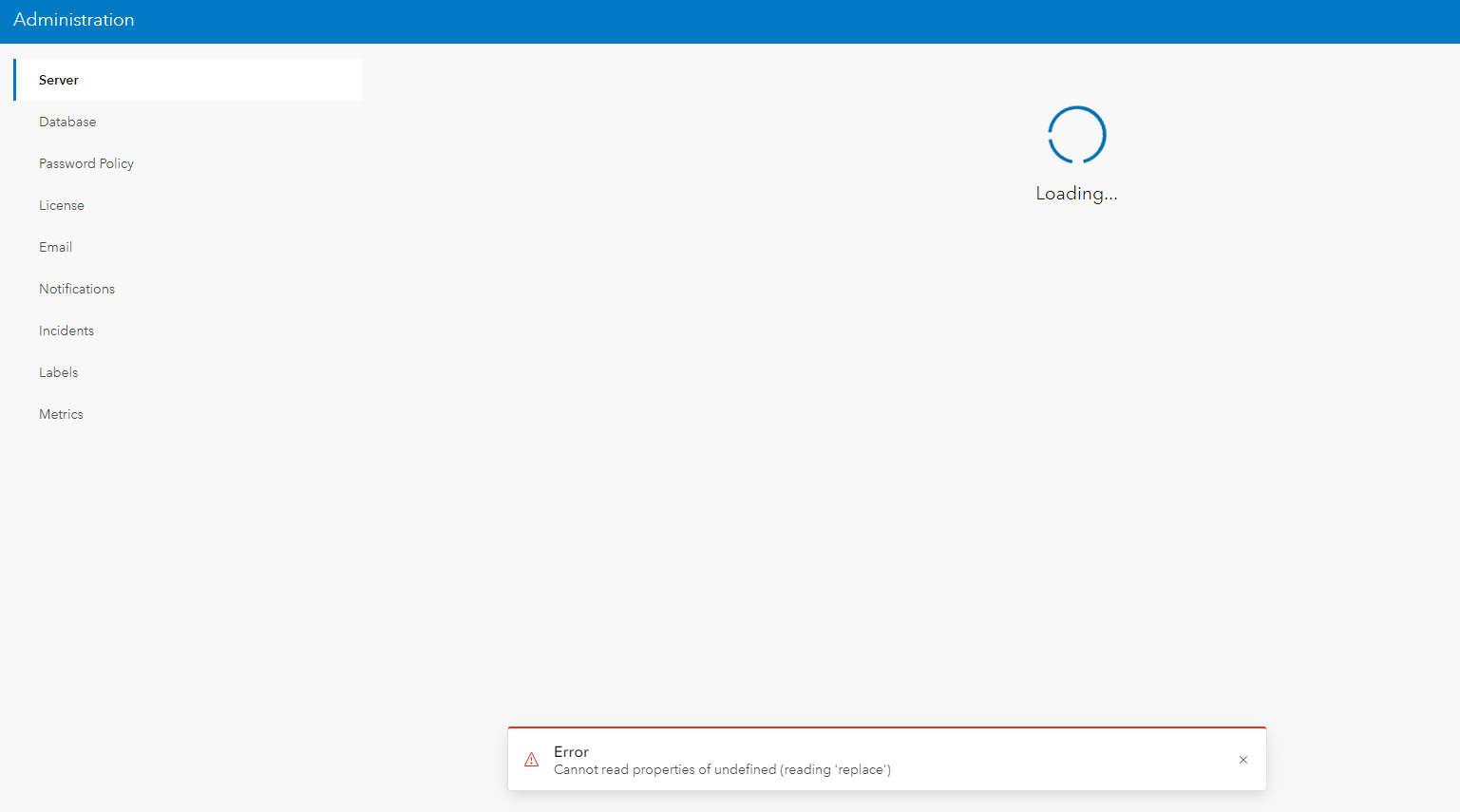

I have ArcGIS Monitor 2023.3.1,
Tried to configure ssl by uploading a pfx file and got the following error
Error- Cannot read properties of undefined (reading 'replace')
From them on when ever browser Administration -> Server it displays the same error and could view and setting as shown below
wondering how could i fix this.

That was indeed the issue. The certificate I was uploading is missing the complete trust chain.
However, after creating a certificate with the whole trust chain, I was unable to upload it because the Monitor UI Administration -> Server was not loading . ( with Error- Cannot read properties of undefined (reading 'replace'))
I have managed to remove the certificate file from the configuration location
C:\Users\<monitor_user>\AppData\Local\ESRI\ArcGISMonitor\config-store-server
which made Monitor fall back to self-signed cert. Then, changed the certificate through Monitor UI and it works now.
