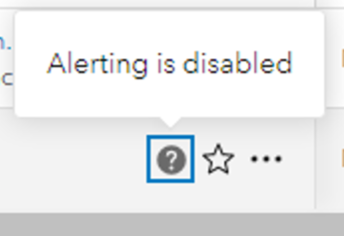

3) The status remains Unknown and says that no alerts have been set up

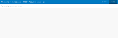

4) No metrics are listed under the metrics tab
5) It causes the agent to disconnected, requiring the window service to be restarted.

When I add register the Linux server, the Status is Unknown and says Alerting is disabled.  Then when I go to the Metrics tab, there are no metrics listed.  Then when I go to the Monitoring>Agents tab, it shows the agent for the server where AM Server is installed is disconnected.
