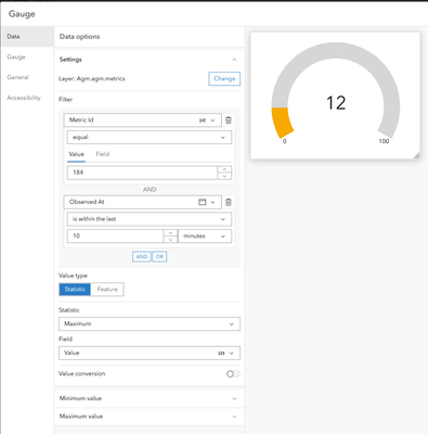

Hi @KevinRathgeber1,
You are correct: there is no out-of-the-box way to grab the last recorded value of a specific metric for gauge elements. However, there are a few different ways of approaching this. The configuration pictured below will display the maximum value of a metric in the past 10 minutes:
Another option is to develop a data expression to extract information. See this community thread for more information.
Josh

I kind of like what you have indicated here, but that is the maximum value, not the most recent.   Thinking this through I might be better to do an average over the last 5 or 10 minutes to kind of indicate the server has been doing because instant may not be a clear picture.
I was starting to contemplate adding some views to the database and using Power BI instead directly against the DB.
