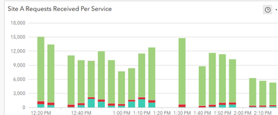

I applied the ArcGIS Monitor 2024.1.1 patch, and everything appeared to be functioning normally. However, today I noticed a gap in the analysis view. All agents are connected, and there are no critical alerts. What could be causing this?

> ... today I noticed a gap in the analysis view.
By "gaps" do you mean the "empty" timeslots, such as at 12:30 and at 1:25? So your expectation is to see some data points at these timeslots, right? This behavior is really odd.

I'm sorry you're still seeing this behavior. I've only heard of this happening once before, but we were unable to reproduce this behavior. Can you please contact Esri Tech Support so they can take a closer look and try to reproduce this issue?

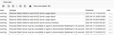

I identified the root cause of the issue: the blank time slot corresponds with the ArcGIS Monitor log, where the Observer failed to read the ArcGIS Server usage report.
