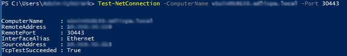

I'm attaching all the tests I ran and a screenshot of the error for reference.

In your 2nd screenshot "monitor_agent_register.jpg", the error message "Unable to connect to target server" when you try to register AM Agent with AM Server, suggests that there's a communication issue between them. Likely cause is that port 30443 is not available. However, I know in your first screenshot "test_connection_monitor_server.jpg", it suggests that port is open. Which machine did you run the test connection from?

The connectivity test to the Monitor Server endpoint was performed from one of the machines that cannot be registered. Both Telnet and browser access to the server return successful results, confirming basic network reachability.
