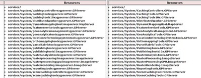

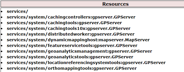

Individual service metrics are missing in my 2024.1 installation monitoring a 10.9.1 Enterprise.
Just a guess for my 10.9.1 install, but the usage report shows resources with 2 seeming issues. First is this ":<serviceType>" after the name and before the ".<serviceType>". Second is the service names are all lowercase. I copied the agm usage report json, created my own, and could verify that every service returns NODATA. Changing either the service folder and name to the correct case or removing the ":gpserver" did not result in valid data returned, but fixing both does. So this should look like "services/System/CachingControllers.GPServer" not "services/system/cachingcontrollers:gpserver.GPServer'.

Here's a comparison of the usage reports from 10.9.1. 2024.1 on the left vs 2024.0.1 on the right.
