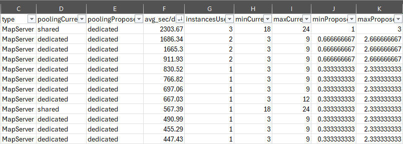

For example, in the following use case we have the following 4 services:
  1. ID 1 and ID 2 have a low usage (<5s) and already recommended shared pool.  Therefore, there is no change.
  2. ID 3 has a low usage (<5s), but dedicated pool. Therefore, pool change from dedicated to shared is recommended.
  3. ID 4 has a high usage and shared pool.  Therefore, pool change to dedicated and min/max instances are recommended

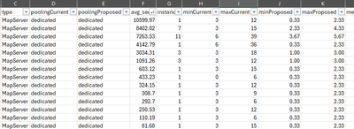

Once you validate the edit=false recommendation, test executing edit=true manullay.  This mode will make changes to instances and pooling and restart services.  If satisfied, user could schedule this as a daily job, using windows scheduled task.
Note, the minProposed is calculated as the ceiling of Instances Used Avg.  In the case below, the ceiling of 1.21 is equal 2.

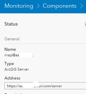

Looks like a great tool, but I am having issues setting it up, particularly arcgis_server in the JSON file.  Any plans on making this tool open-source by chance?
AndrewSakowicz
@GaryNEORSD FYI, source code included in https://prof-services.maps.arcgis.com/home/item.html?id=f9c3e2864054444fb87e54575b11a96a . Also, what issue do you have?
GaryNEORSD
Occasional Explorer
@AndrewSakowiczThanks, I was able to access the desktop application using that link.  I mean to say is the python file(s) used to build the executable available?
AndrewSakowicz
@GaryNEORSD yes, I just included python files.  Please download again.  You should see source_code_xx.zip folder with the python code

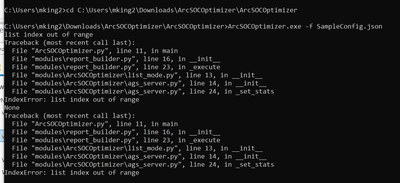

meloking_PNM
@AndrewSakowicz I've downloaded the zipped file, extracted, and adjusted the SampleConfig.json with my ArcGIS Monitor/ArcGIS Server's values as suggested above. Could you provide guidance on what is causing the error below when I run the exe via command line as described above?
René_Ténière
I am having the same issues @AndrewSakowicz

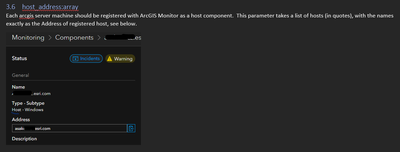

AndrewSakowicz
@meloking_PNM , @René_Ténière  please check component_address string for both arcgis server and host in config file
are exactly as in ArcGIS Monitor
René_Ténière
Thanks! That was the issue.

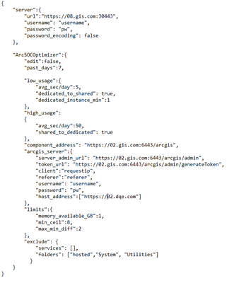

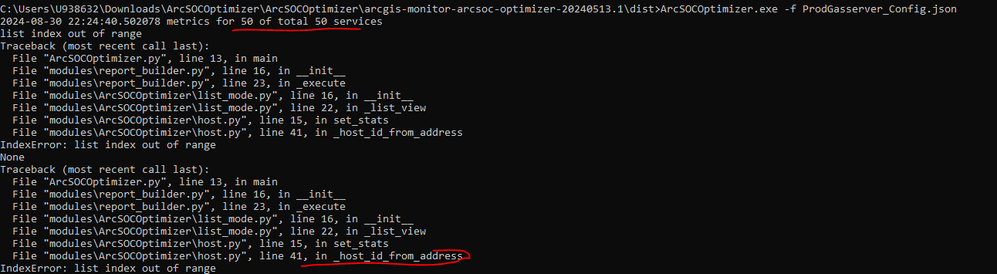

LouEarly
@AndrewSakowicz

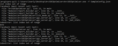

Im having issues with the json as well. See the image below.  The 02 machine is our ArcGIS server and the 08 machine is the server with monitor installed. When running the exe in cmd i'm getting the same error that was shown above. I've checked the URL's and they are exactly whats in monitor.
AndrewSakowicz
@LouEarly , it looks like a mistake in your host input.  it should not start with https..., it should be 02.gis.com.  But double check in host address, see below

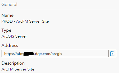

@AndrewSakowicz It is configured in monitor using the LB. What config file specifically are you asking for? Sorry for my confusion.
AndrewSakowicz
SampleConfig.json.  Note, this is not correct "configure the json using that URL instead of the individual machine names".  Please follow the documentations

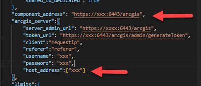

MarieCline_Delgado
@AndrewSakowicz  I have had the ArcSOC Optimizer running smoothly in list mode for about a month now.  I recently switched to edit mode and the reports are listing a couple different errors in the minMaxChange column for the services it attempts to edit.  Do you have any advice on how to solve these errors?
I don't know what to make of this error:
{"status":"error","messages":["Could not find resource or operation 'admin' on the system."],"code":404}
Here, it makes sense that an error is returned if it is trying to use the server admin token to access the portal sharing rest site, I'm just not sure what the solution is:
{"status":"error","messages":["Server machine 'https://x.y.com:7443/arcgis/sharing/rest/community/self' returned an error. 'Invalid token.'"],"code":498}
I appreciate any help you can provide! Thank you!
Marie
AndrewSakowicz
@MarieCline_Delgado , please verify your input.  Note you'll have to provide correct client , referer: "arcgis_server":{
"server_admin_url": "https://xxxx:6443/arcgis",
"token_url": "https://xxx:6443/arcgis/admin/generateToken",
"client":"referer",
"referer":"referer-value",
"username": "xxx",
"password": "xxx",
"password_encoding": false,
"host_address":["xxx"]
MarieCline_Delgado
Thanks @AndrewSakowicz !  I completely missed the referrer value.

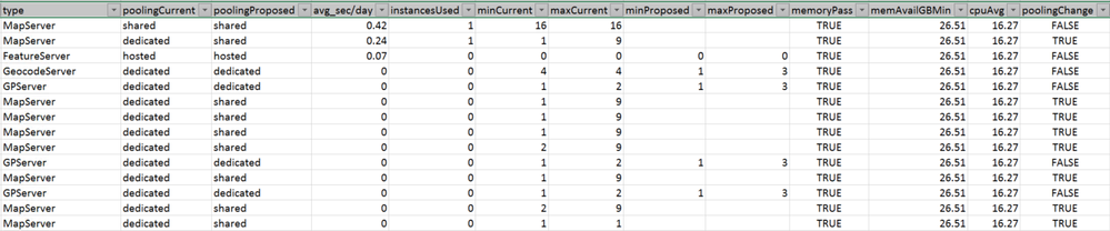

Hello.
I recently installed this and am trying to figure out if it is working properly.
The report generated doesn't seem to be gathering all the required data, or it for some reason is rounding values to (0).
We have a multi-tiered environment consisting of 6 servers (WebAdaptor, Portal, Host, Geo, Mapping, and DataStore).  Plus an independent server for ArcGIS Monitor.
Servers are all Window servers running Windows Server 2022 Standard.
Enterprise is running ArcGIS Enterprise 11.2 and Monitor is running 2023.3.
The screen shot below is showing the top 14 services.  I have been testing different dashboards, so other services should be showing values greater than (0) in avg_sec/day and instancesUsed, etc.
I am trying to figure out if this is what should be expected or if something is still a bit off.
Do we know if there are any issues related to using Enterprise 11.2?

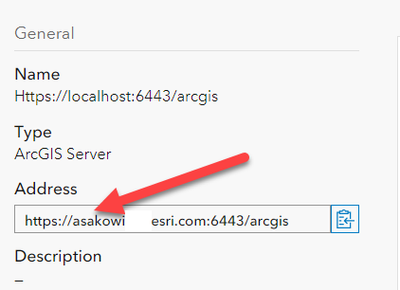

AmoghMahesh
@AndrewSakowicz I followed the instructions, took the hostname and url from the arcgis monitor,
so now im able to authenticate, but still getting index out of range on _host_id_from_address, could you please me what needs to be on the input file?MicrosoftTeams-image.png
AndrewSakowicz
This error indicates the input for host_address is incorrect.  Please search this threat for "host_address".  there is help and several similar cases and resolution.  I hope it helps.

Hi @AndrewSakowicz,
I hadn't checked my reports for a while, but I noticed after upgrading to ArcGIS Monitor 2024.0 and prior to updating to the 20240929.0 version of the tool, none of my ArcSOC Optimizer reports had been generating. Since updating to the new version yesterday the reports are now generating for my federated ArcGIS Server site, but still not for my standalone/non-federated site. I'm getting:
10/02/2024 06:05:29 AM ERROR: list index out of range
10/02/2024 06:05:29 AM ERROR: None
File "ArcSOCOptimizer.py", line 13, in main
File "modules\report_builder.py", line 16, in __init__
File "modules\report_builder.py", line 23, in _execute
File "modules\ArcSOCOptimizer\list_mode.py", line 13, in __init__
File "modules\ArcSOCOptimizer\ags_server.py", line 14, in __init__
File "modules\ArcSOCOptimizer\ags_server.py", line 27, in _set_stats
IndexError: list index out of range
Thanks as always!

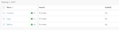

AndrewSakowicz
@ChrisTaylor2  the error implies there might be issues with the observers of this particular arcgis server component.  Please check if observers are running. you should see something like the following:
Another thing to double check is that that component_address in config is exactly as address in the monitor,
e.g.
Perhaps a new local agent might have picked a web adapter for address url, but before you had 6443 and now address in monitor and component_address in config don't match?
ChrisTaylor2
@AndrewSakowicz - thank you, that got it! Your suggestion about the new local agent picking the web adaptor url for the address was the case. Once I changed the configuration file to match the address in Monitor and re-ran, it completed successfully.
Thanks again!
Craig_Lunde
I am getting alternating errors when I try and they continue to alternate no matter what I  try changing. We are using the latest monitor update and version 20241002.0 for ArcSocOptimizer.
First one
File "ArcSOCOptimizer.py", line 14, in main
None
Second Error
version:20241002.0
'access_token'
File "modules\report_builder.py", line 12, in __init__
File "modules\User_Input\user_inputs.py", line 10, in __init__
File "modules\User_Input\user_inputs.py", line 37, in _get_token
KeyError: 'access_token'
None
AndrewSakowicz
@Craig_Lunde , please see above post from ChrisTaylor2 and the solution, ArcSOC Optimizer for ArcGIS Monitor - Esri Community
Craig_Lunde
@AndrewSakowicz I have tried using what monitor has as the address and the webadaptor url, I get the same alternating errors. The observers are all showing green. I created a new config file from the updated version. Monitor shows the server address as https://XXXX1XXXX11.xyzxy.xy.local:6443/ and host address as XXXX1XXXX11.xyzxy.xy.local. I have never used these fields before but could it be the client or referer being wrong?
ChrisBerryman
For running this against a site with 3 machines, i have been running it against the primary machine (machine 1).  when it recommends pooling changes it could say a max of 2 instead of 3 which is currently set on a single machine but then tripled to become 9.
how does everyone else handle running against a server site that's comprised of more than 1 machine?
ChrisTaylor2
Hi @ChrisBerryman - thanks for posting your question. I've been close to posting a similar one in the past but haven't yet so this was the kick in the butt I needed 🙂
I've found it requires a bit of mental gymnastics for me when I'm analyzing the reports for my 3-machine site. First, for the minCurrent and maxCurrent I have to divide by 3 to get the current 'per machine' value that I want to use to compare against the proposed values. But the minProposed and maxProposed values are in decimal form for me for dedicated services (maybe I'm doing something wrong?) so I just round them up to whole numbers. This is what a typical report looks like for me:
It's still manageable and I'm certainly appreciative to have the report, but it just takes more mental effort than my single-machine sites.
ChrisBerryman
@ChrisTaylor2 yeah mine looks similar.
Glad to see we are in the same boat.   Would be nice to get ESRIs take on this.
