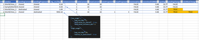

edit=false
Start with edit=false (default).  This will generate a report with recommendations, without making any changes. Review the recommendation and change the inputs if needed, especially avg_sec/day for low and high usage.  Repeat the process as needed.

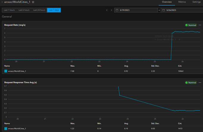

For example, in the following use case we have the following 4 services:
  1. ID 1 and ID 2 have a low usage (<5s) and already recommended shared pool.  Therefore, there is no change.
  2. ID 3 has a low usage (<5s), but dedicated pool. Therefore, pool change from dedicated to shared is recommended.
  3. ID 4 has a high usage and shared pool.  Therefore, pool change to dedicated and min/max instances are recommended

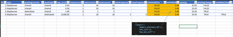

edit=true
Once you validate the edit=false recommendation, test executing edit=true manullay.  This mode will make changes to instances and pooling and restart services.  If satisfied, user could schedule this as a daily job, using windows scheduled task.
Note, the minProposed is calculated as the ceiling of Instances Used Avg.  In the case below, the ceiling of 1.21 is equal 2.
Memory limit
If memory available is less then specified memory_available_GB limit, the edit will not be executed.  In that case, user should lower this limit or free up memory manually.
