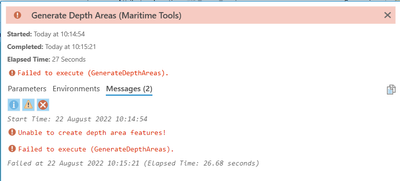

Hi,
I am trying to create Depth Area using "Generate Depth Areas" from Point feature. Steps followed are:
1. Create TIN
2. Delineate TIN Data Area
3. Smooth Bathymetric TIN
4. Surface Contour
5. Generate Depth Areas
But the tool fails without any error message. Am I missing any step?
Can someone help?
CraigTGreene
If you are on the 3.0 release, you need to make sure that all features being used in the Generate Depth Area tool are in the same coordinate system. We have made a change in 3.0.2 that will allow you to use features with different coordinate systems.
S6
by Esri Contributor
Hi CraigTGreene,
Thank you for the reply. Yes, all the features are in same coordinate system - yet the tool fails. Any other parameter I should check?
CraigTGreene
It's difficult for me to say without seeing the data. Is it possible for you to provide the data so we can test?
S6
by Esri Contributor
Sure, sending you the sample in private message.
