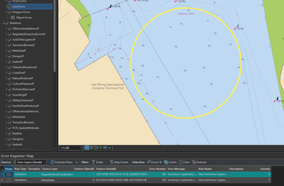

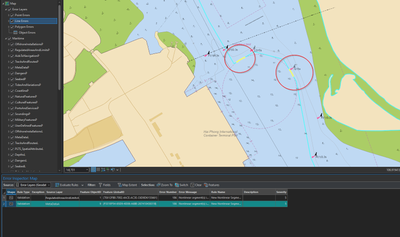

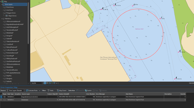

Using the Nonlinear Segment check, I found two features with nonlinear segments in MetadataA (ObjectID 9) and RegulatedAreasAndLimitsA  (ObjectId 1) feature classes.
To remove non-linear segments, you can use the Generalize feature tool. Use Densify method  for generalizing selected features. The tool will insert vertices at constant intervals and change curved segments to a series of line segments. To find the proper densify distance value, you need to determine the desirable vertex spacing. S-57 specifies a minimum vertex spacing of 0.3 mm at scale. This value converts to 0.0003 m at scale. You should apply this limit when converting the circular arc into straight segments. For example, at 1:22000, the minimum vertex spacing is 22000 x 0.0003 = 6.6 m.
Error geometry for RegulatedAreasAndLimitsA:
Error geometry for MetadataA:
To maintain coincident boundaries with adjacent features, turn on map topology  before using the Generalize tool.
