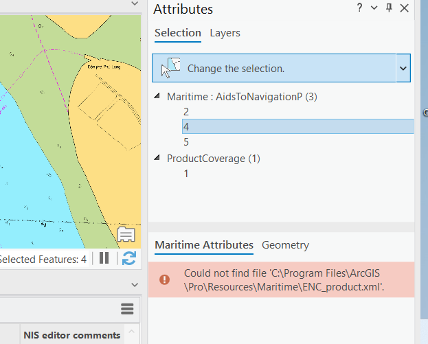

Hi All,
I am using ArcGIS Pro 3.0 for ENC creating, when I select a feature for attribute editing, could not see the Maritime Attribute.
Anybody can help on this?

Hello @TonyDao
Was ArcGIS Pro installed for all users on the machine or for current user only?
Do you have access to the C:\Program Files\ArcGIS\Pro\Resources\Maritime\ directory?
Are you using folder redirection/DFS namespace in your setup?

ChrisUnderwood
Hello @TonyDao , does the file that the error message references, C:\Program Files\ArcGIS\Pro\Resources\Maritime\ENC_Product.xml, exist on the system you are using ?

Hello Chris,
Nope, by default when Arcgis Pro was installed, the file doesn't exist.

TonyDao
Many thanks Paula! I got problem solved
