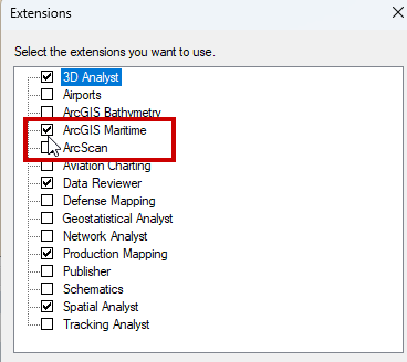

PaulinaKarkauskaite
Hello @NauryzbekAbylkair ,
Can you verify that the Maritime extension is activated in ArcMap?
Thank you,
