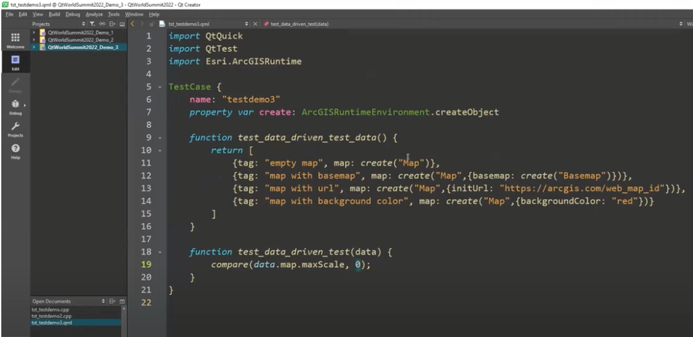

Tune in to the recording at 9:15 for a demo of data-driven test code using different types of maps data, e.g. map with a basemap, map from a URL and an empty map!
