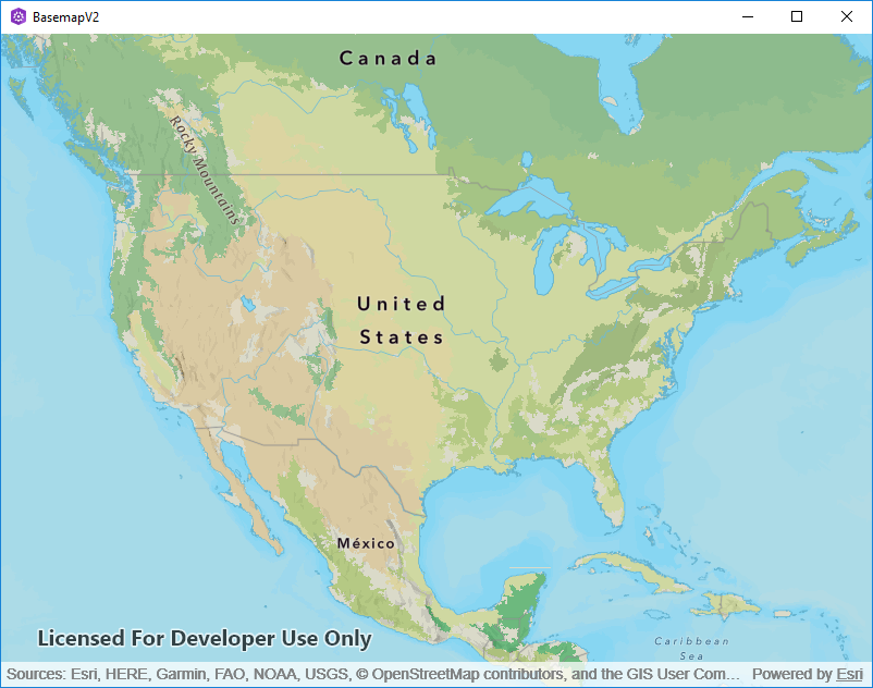

When you run your app you will see the beautiful new ArcGIS Outdoor style basemap displayed.
