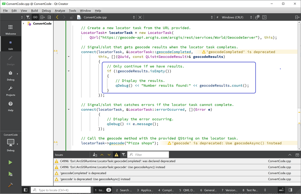

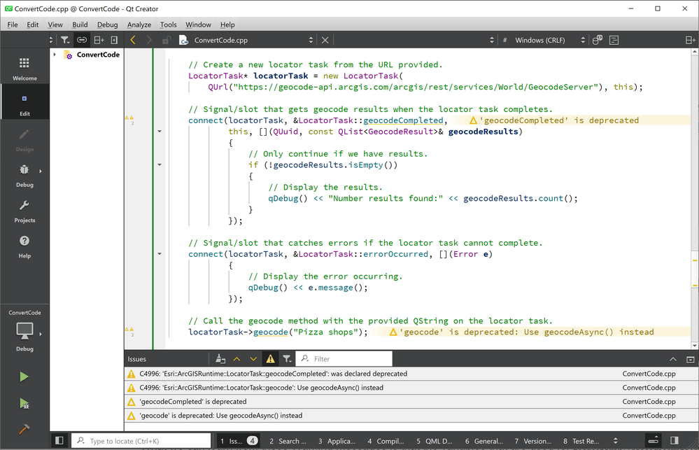

To modernize this code, the first thing you will want to do is to figure out which Qt Maps SDK methods can be converted to the new "Async" and QFuture programming pattern. The Qt Creator IDE helps us to know which asynchronous methods can be upgraded. If you are using an older version of the Qt Maps SDK binaries, you will want to upgrade to the latest version (which is v200.4 at the time this blog article was written). Once you are using the latest version of the SDK, in Qt Creator choose Build > Rebuild to compile your app and look for any warning messages that have text like:
  • C4996: 'Esri::ArcGISRuntime:xxxxxxx': Use xxxxxxxxxxxAsync() instead
  • 'xxxxxxxxx' is deprecated
See the following screen shot:
In our case, using the code snippet above, the Qt Creator yields the following 4 warning messages:
  • C4996: 'Esri::ArcGISRuntime::LocatorTask::geocodeCompleted': was declared deprecated
  • C4996: 'Esri::ArcGISRuntime::LocatorTask::geocode': Use geocodeAsync() instead
  • 'geocodeCompleted' is deprecated
  • ' geocode' is deprecated: Use geocodeAsync () instead
What we can learn from these warning messages is that the variables that are used for LocatorTask::geocodeCompleted and LocatorTask::geocode can be eliminated to take advantage of the new "Async" and QFuture programming pattern. Even though there are 4 warning messages, and we have 2 ArcGIS Maps SDK for Qt types being impacted, we will only use 1 of the new "Async" methods and that is the LocatorTask::geocodeAsync method.

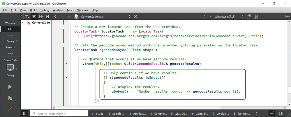

The next thing I like to do is to copy everything that was in the older pattern for the connect slot for the LocatorTask::geocodeCompleted inside of the curly brackets into the curly brackets for the "continuation block" to the QFuture in the .then() method. This is best demonstrated with some screenshots.
We copy that part of the code that is circled in blue from within the connect signal for the LocatorTask::geocodeCompleted inside of the curly brackets:
Into the curly brackets for the "continuation block" to the QFuture in the .then() method (the copied section is circled in blue):

The next coding change we need is to copy everything that was in the older pattern for the connect slot for the LocatorTask::errorOccurred inside of the curly brackets into the curly brackets for the QFuture's .onFailed() handler. This is best demonstrated with some screenshots.
We copy that part of the code that is circled in blue from within the connect signal for the LocatorTask::errorOccurred inside of the curly brackets:
