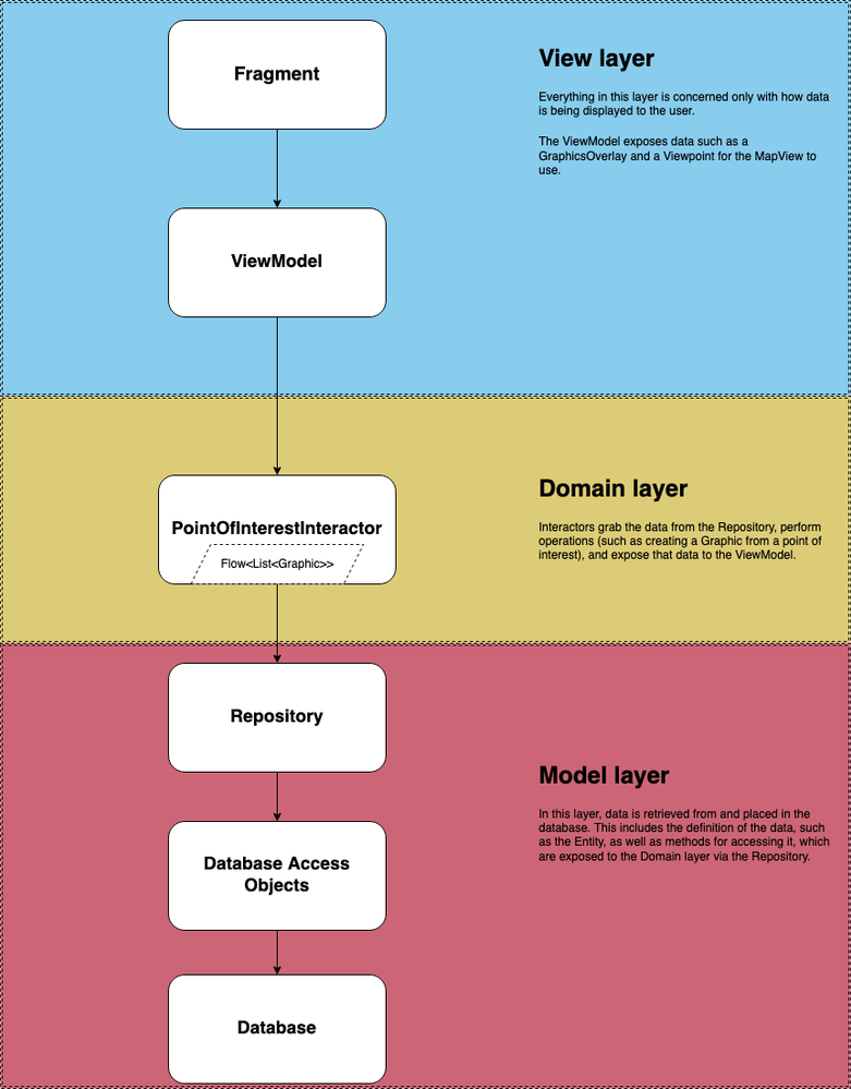

To support these features we've used the following architecture:
  • The database is created with Room, a library for creating and accessing SQLite databases for data persistence. We can access the database using a Database Access Object (DAO).
  • A Repository class exposes the data. In a more complex, online app, this class would interface with a server to ensure data in the database is kept up-to-date.
  • Interactor classes perform business logic on the data. For example, the PointOfInterestInteractor creates the graphics for the points of interest in the database. While this could be done in the ViewModel, we separate these common operations into Interactors so future additional ViewModels could share the logic.
Hilt takes care of dependency injection for us. Note the DatabaseModule class, which provides Hilt with a method to create the database; the @Inject constructors on our Repository and Interactors; and the @HiltViewModel annotation on the ViewModel class. With these simple additions we can avoid the hassle of creating the dependencies for each class in separate factory classes.
The architecture of the app shown above highlights the flow of dependencies. Components higher up on the graph depend on components lower down, but not vice versa. This means that swapping out components will not change the behavior of components above them.
This architecture is largely based on MVVM (Model-View-ViewModel) as outlined in the Guide to App Architecture, with the addition of a "domain layer" to handle some business logic code, based on the implementation from this article.

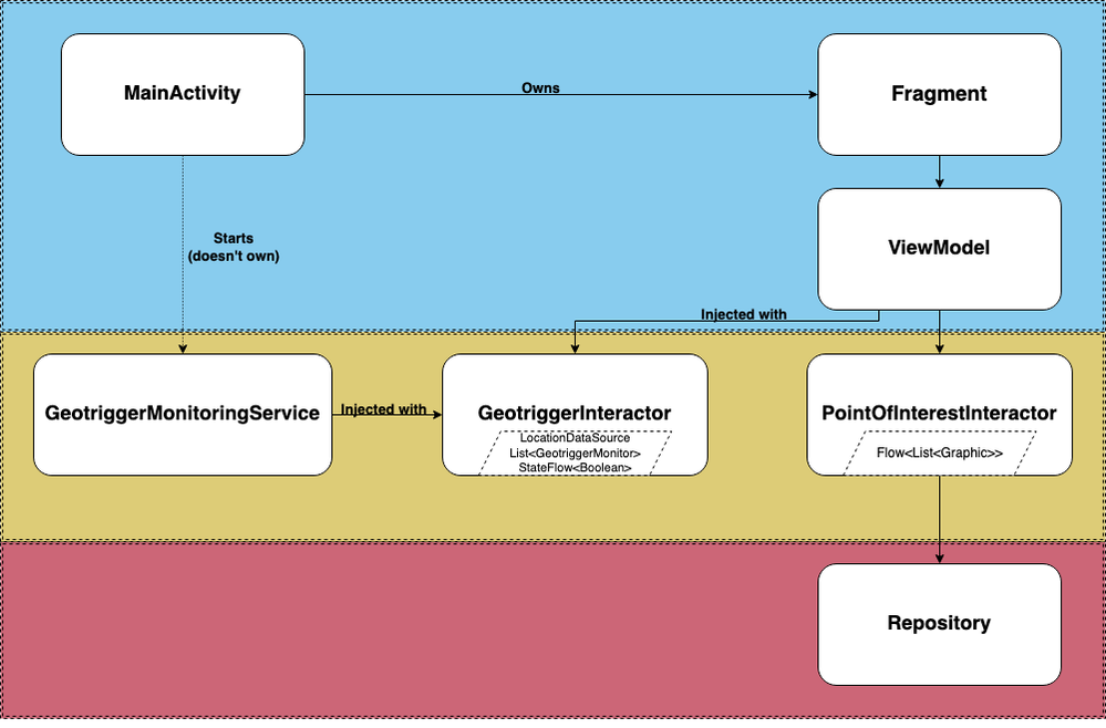

Our solution is built around a GeotriggerInteractor class which creates the Geotrigger, monitor, location data source, and signals to start and stop monitoring. Using Hilt annotations, we mark this class as @Singleton to ensure that only one instance is created. We also add an @Inject constructor taking in the @ApplicationContext. This allows us to create an AndroidLocationDataSource using the application context, which will survive backgrounding. (Note: while this example uses the AndroidLocationDataSource, any LocationDataSource could be implemented this way.)
The signal to start and stop monitoring is implemented as a StateFlow<Boolean> which we can use to access the status from other classes; it can be converted to a LiveData<Boolean>, but can outlive any lifecycle owners required by a LiveData.
In this example, the Geotrigger is created using a GraphicsOverlay from the MapViewModel. This could arguably break the flow of dependencies in the application, but reduces the code for this sample. Another implementation might instead create a GraphicFenceParameters using graphics from the PointOfInterestInteractor, or a FeatureFenceParameters from an online Feature Service.
The GeotriggerMonitoringService is relatively simple. The key line here is:
@Inject
lateinit var GeotriggerInteractor: GeotriggerInteractor​
This tells Hilt to inject the Interactor after the Service is created. Because our GeotriggerInteractor is marked as a singleton, we know that it's the exact same instance as the one created for the ViewModel. It's important to annotate the Service class with @AndroidEntryPoint so that it can interface with Hilt. Finally, all we need to do to monitor the Services from here is to subscribe to the shouldMonitor signal as such:
GeotriggerInteractor.shouldMonitor.asLiveData().observeForever{...}​
