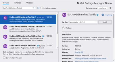

Toolkit for ArcGIS Runtime SDK for .NET is hosted as a Nuget package. You can get started by adding the following line to your project’s .csproj file:
<PackageReference Include="Esri.ArcGISRuntime.Toolkit" Version="100.15.0" />
Or you can use the package manager in Visual Studio:
After the package is added to your project, you're just one more line of code away from a working trace tool:

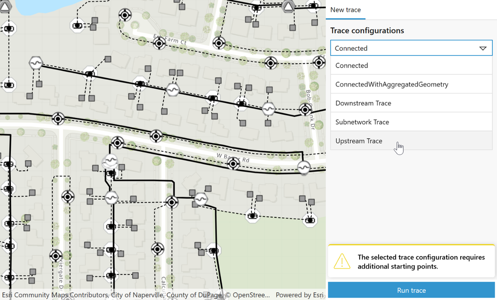

Web maps power the Utility Network Trace Tool. When a map includes a utility network, any associated named trace configurations are loaded. If there are multiple utility networks, you can select which network to use. Otherwise, the first step is to choose a trace configuration from the list:

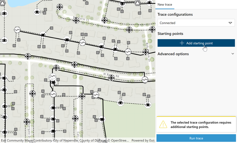

After selecting the trace configuration, you define starting points for the trace. You can add starting points programmatically or by interacting with the map.

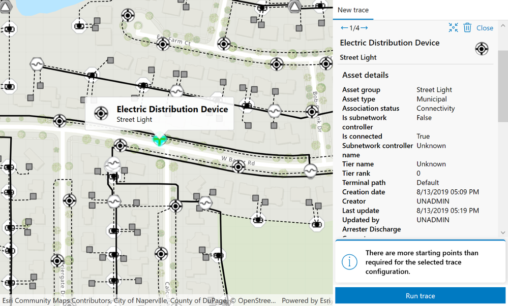

Trace starting points often overlap, so the tool uses a wide area tolerance to simplify selecting the desired point. You can then inspect the popups for individual starting points if you need additional information to make the right choice.
While in the inspection view, you can see the popup and symbology, with the option to delete the starting point:
