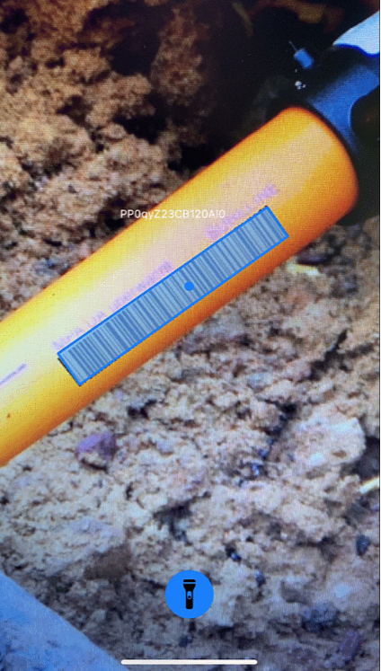

Barcode scanning in FeatureFormView
The Feature Form component now supports scanning barcodes to input values for a field. When an authored form contains a field with a `BarcodeScannerFormInput`, the field will display a "Scan" button. Tapping the button will display the image from the camera, allowing users to scan a barcode and automatically fill the text field with the result of the scan.
