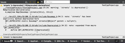

To simplify identifying deprecated APIs in C++, we’ve created a macro,  QRT_DEPRECATED, that will raise compiler warnings for any deprecated usage in your app. The warnings will show up in Qt Creator like this:
Qt Creator will also call out any usage in the code editor, making it very easy to identify where to make the changes.

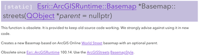

After identifying deprecated API usage, consult the API reference doc to find a suitable replacement and make appropriate changes to your code.
