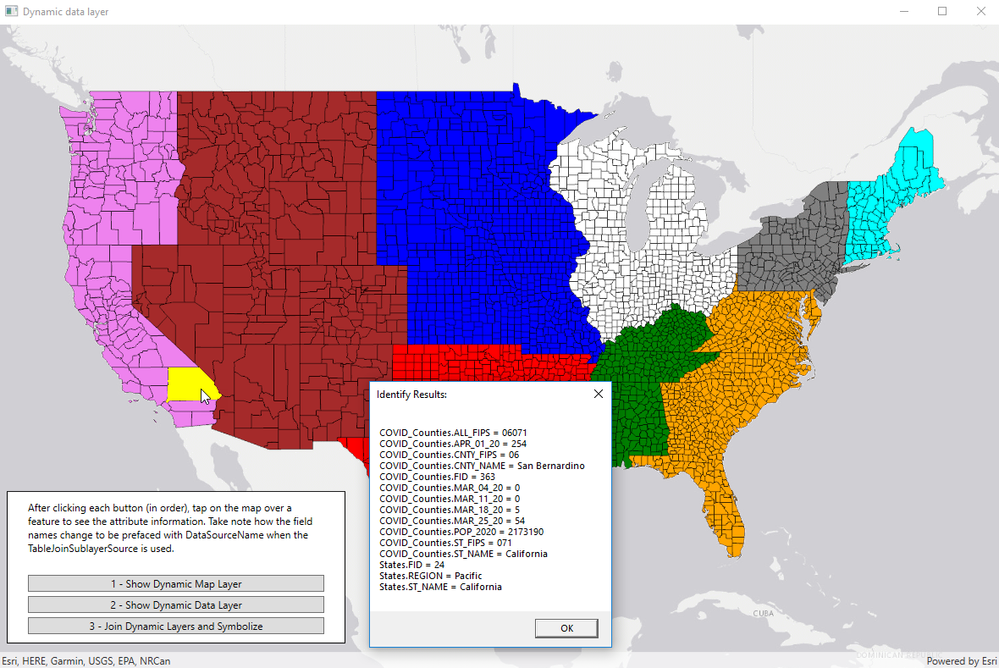

This file contains the main logic for the running of the app. There are 7 main sections worth discussing to provide insight on how the app works:
(1) The using statements at the top of the file shorten the syntax for writing the code.
(2) The IntializeMap() function sets up the initial look of the GUI. It adds the world light gray base map, zoomed to the area of the continental USA to provide orientation for the operational layers. A default GraphicsOverlay is created to aid in the identify process. Finally, the GeoViewTapped event is wired up to handle the user map taps, to obtain the identify results.
(3) The ResetLayers() function will clear out any graphics in the GraphicsOverlay from a prior identify operation, and clear out any prior operational layers that were created by adding dynamic layers.
(4) The Button_DynamicMapLayer_Click() function adds a dynamic map layer to the application showing USA county COVID-19 cases. The default rendering of the layer comes from the published ArcGIS Server map service that was authored in a prior blog post. The dynamic map layer is created via the MapSubLayerSource object to create an ArcGISMapImageSubLayer object. The dynamic map layer is attached as an ArcGISSubLayer of the ArcGISMapImageLayer and added to the map.
(5) The Button_DynamicDataLayer_Click() function adds a dynamic data layer to the application showing the USA state boundaries. This is the layer that was created using the ArcGIS Server Manager and is only accessible when the WorkspaceID and DataSourceName strings are known to the developer or user of the app. The dynamic data layer rendering must be specified by the developer in the app; in our case we use a SimpleRenderer based on a SimpleFillSymbol. The dynamic data layer is created via the TableSubLayerSource object in order to create an ArcGISMapImageLayer.  The dynamic data layer is attached as an ArcGISSubLayer  of the ArcGISMapImageLayer  and added to the map.
(6) The Button_JoinDynamicLayers_Click() function creates a dynamic layer based on the TableJoinSublayerSource object. The TableJoinSublayerSource takes any two abstract SubLayerSource objects and joins them together based a common field in the attributes. In our case, we will join together the USA counties layer using a MapSubLayerSource, and the USA states layer using a TableSubLayerSource as the abstract SubLayerSource types. The common field to join the two dynamic layers is the state name (ST_NAME). To make things visually appealing, a UniqueValueRender was used to show which counties belong to a particular region of the USA. I used the term dynamic layer in the generic sense for this function; think of it as a hybrid of information coming from a dynamic map layer and a dynamic data layer.
(7) The MyMapView_GeoViewTapped() function provides attribute information on the dynamic layers in the map where the user taps. The existing GraphicsOverlay is obtained and cleared from previous user interaction. Using the IdentifyLayersAsync method, the IdentifyLayerResult object is returned and SubLayerResults are obtained. While iterating over the results, the GeoElement is obtained and used to construct a yellow solid fill. It is then added to the GraphicsOverlay. Additionally while iterating over the results, the attribute information is obtained. By iterating over the Attributes the Key/Value pairs for each identified county, the results are present back to the user in a MessageBox.

   // Provide instructions on how to use the app
   TextBlockInstructions.Text = "After clicking each button (in order), tap on the map over a feature to see" +
     " the attribute information. Take note how the field names change to be prefaced with DataSourceName" +
     " when the TableJoinSublayerSource is used.";

  private void Button_JoinDynamicLayers_Click(object sender, RoutedEventArgs e)
   // In this function we will create an ArcMapImageSubLayer based on a TableJoinSublayerSource.
   // The TableJoinSubLayerSource takes 2 input generic SubLayerSource objects. We will use
   // the MapSublayerSource and TableSublayerSource objects just like in the
   // Button_DynamicMapLayer_Click() and Button_DynamicDataLayer_Click() functions above.
   // Additionally, we will specify the fields in each of the SubLayerSource's attributes that
   // will be used to join the spatial datasets together to create the TableJoinSublayerSource.

   // IMPORTANT: When supplying a field name for a renderer (UniqueValue and ClassBreaks) that is
   // based on a table join, you must fully qualify the field name by including the DataSourceName
   // (ex: "State.REGION" for a shapefile, or "ss6.gdb.States.REGION" for RDBMS or SDE).
   myUniqueValueRenderer.FieldNames.Add("States.REGION");

After the code complied without any errors, it was time to test out the app. When the app opens, it shows the basemap layer of the world light gray base, zoomed into the continental USA.
First, let's click the 1 - Show Dynamic Map Layer button. This will add a USA counties dynamic map layer based on the ArcGIS Server published map service. Then, tap on any county to see the attribute information display for that record.
Second, click the 2 - Show Dynamic Data Layer button. This adds a USA states dynamic data layer based private registered dataset using ArcGIS Server Manager for the ArcGIS Server published map service. Then, tap on any state to see the attribute information display for that record.
Third, click the 3 - Join Dynamic Layers and Symbolize button. This adds a dynamic layer to the map that is a hybrid of a dynamic map layer and a dynamic data layer. The map shows the USA counties layer that has the attribute information from the USA states layer joined to it. Tap on any county to see the attribute information and you will find the attributes are display from both data sets. The layer will use a unique value renderer to show the counties by the region of the USA they belong to. Notice the identify results MessageBox to see that the name of the fields are prepended with which data layer the attribute belongs to. This shows the power of a spatial join, and accessing information that you want to keep private.
