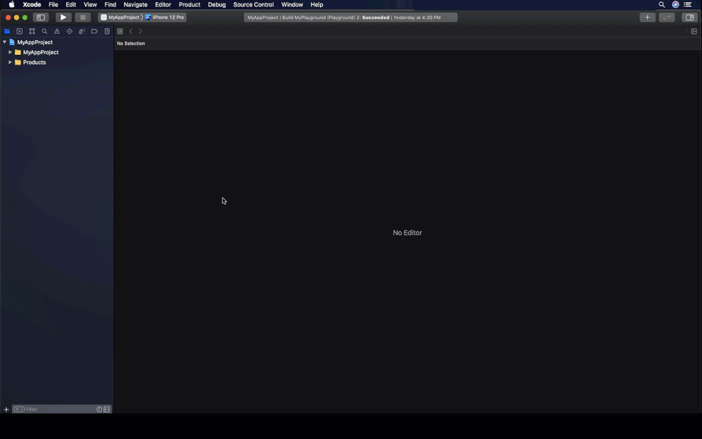

  • Swift Package Manager support: That's right. With 100.11, you can now integrate the ArcGIS Runtime into your projects using the Swift Package Manager.swiftpm.gif
    View the release notes for full instructions.
