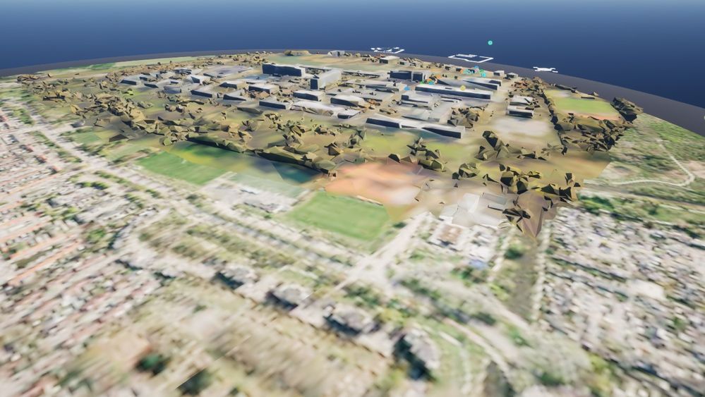

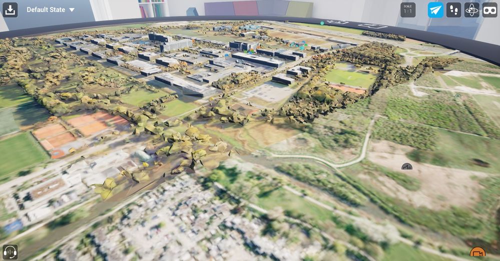

Hi,
Maybe I am missing something but the arial images and integrated mesh quality is different when we switch over to the map scene in Unreal. This happens only in runtime in Unreal Engine and followed every step as described here https://developers.arcgis.com/unreal-engine/maps/tutorials/display-a-map-ui/HTC_IoT_BIM.jpgHTC_IoT_BIM_TableTop.jpg

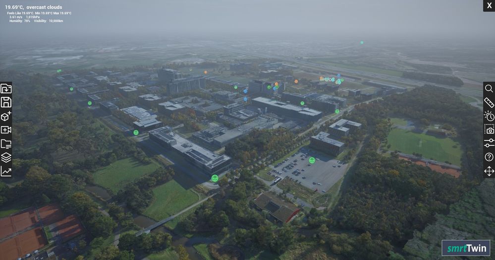

in the SmrtTwin image what format is the data in? Is it already in in slpk format? I am not familiar with that tool. Do you by chance have access to arcGISPro to look at the data in there. Should be able to prove if it was a data issue or an issue with our sdk.

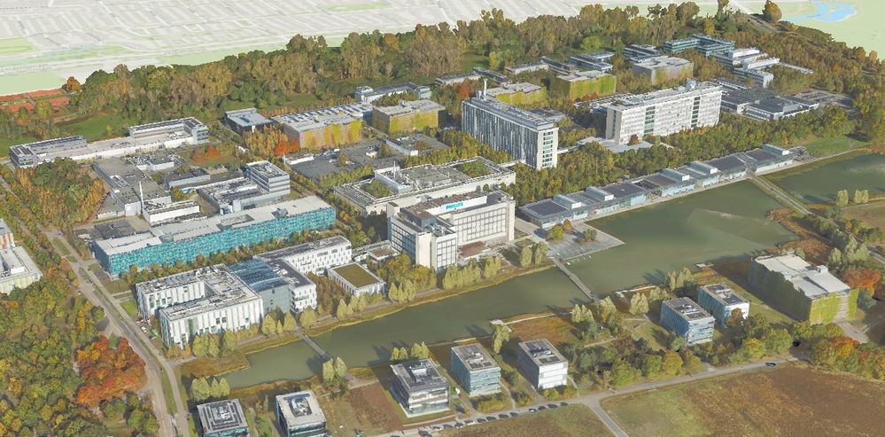

Hi @Matt_Nelson ,
Here is a screenshot of the slpk file inside ArcGIS Pro and no problem with the data at all. The data is showing fine in the main scene (see the first posted image above), once we load the same data in the tabletop level we see the low res using the display map setup the quality is very bad. This happens only in runtime mode and it looks like of the LODs are not loaded. Inside the editor the LODs are loaded perfectly. Even the Basemap quality is really bad as you can see in the other shared images above in runtime

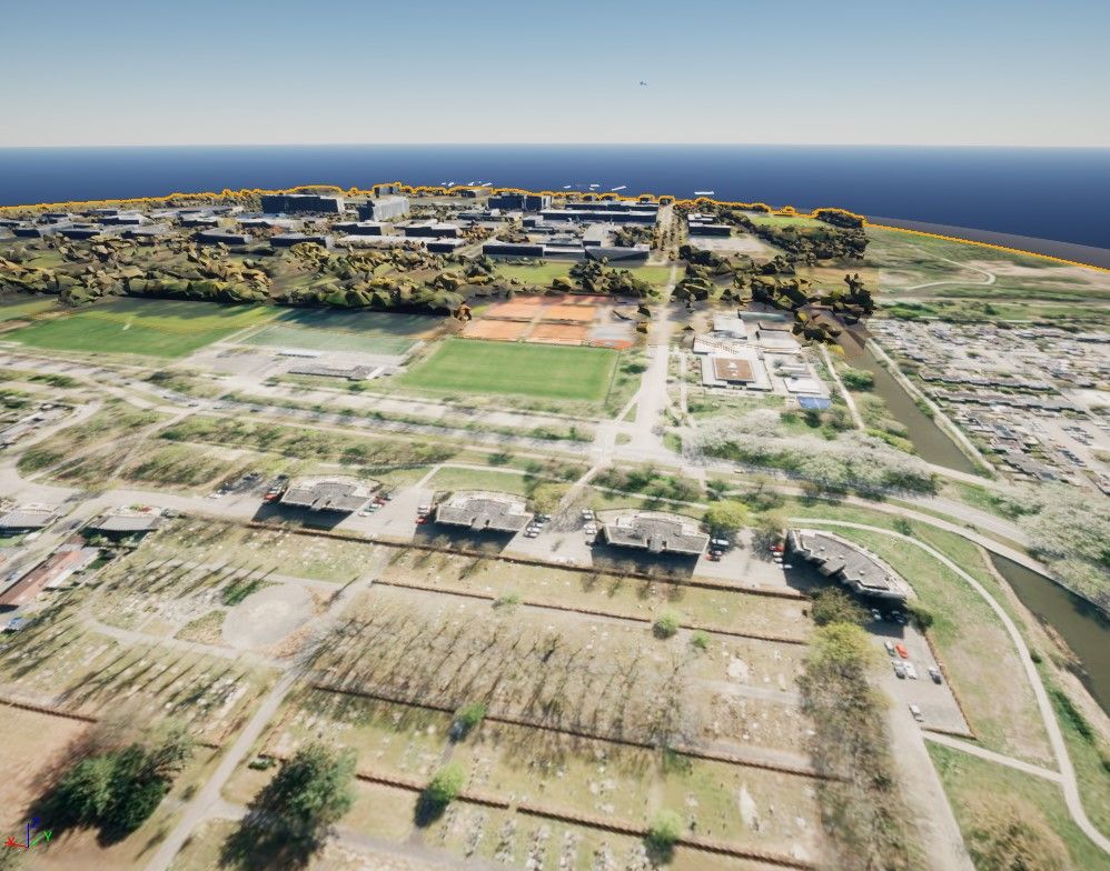

AydinUluc
and here is the same view in the editor where you can see that the basemap and 3d mesh layer are higher quality.
AydinUluc
Another thing that I found out is that if you only load the basemap the image quality is good but once you add a new layer (3dobject or mesh) then the image quality drops and no LODs of the 3dobject and mesh is loaded as shown in the screenshots
