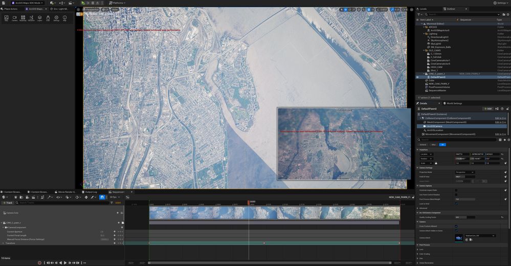

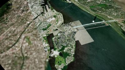

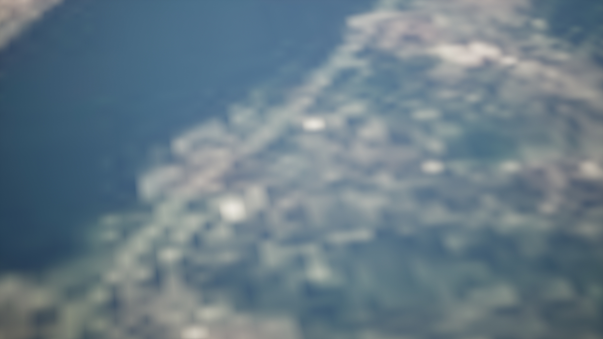

I am having trouble rendering a high resolution basemap from sequencer. The camera is animated and it appears that the tiles are not loading properly. I have tried Quality Scaling Factor with the GIS camera but I get the same results. I am using a spawnable camera in the sequencer and I have also tried a regular cine camera with the default pawn attached /parented. Any suggestions would be really appreciated as I'm at a loss of what to try next. I attached a couple images for reference. UE5.1.1 ArcGIS Maps 1.3.0
Thanks,NEW_CAM_PAWN_F.0196.jpegCine Cam with default pawn attachedSequenceMaster.1132.jpegspawnable cam in sequencer

I have made some progress but it seems the pawn radius for high resolution is limited, how can I increase the radius? BTW I am not parenting, the pawn is at the center of the high resolution as you can visibly see the falloff.

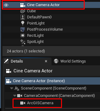

I resolved it by adding a ArcGISCamera component to the CineCamera
There's a bit more documentation about it here - https://developers.arcgis.com/unreal-engine/maps/camera/#render-a-video
On that same documentation page it mentions how to adjust the 'Quality Scaling Factor' which can also help if you're trying to force higher resolution for particular camera FOVs.
