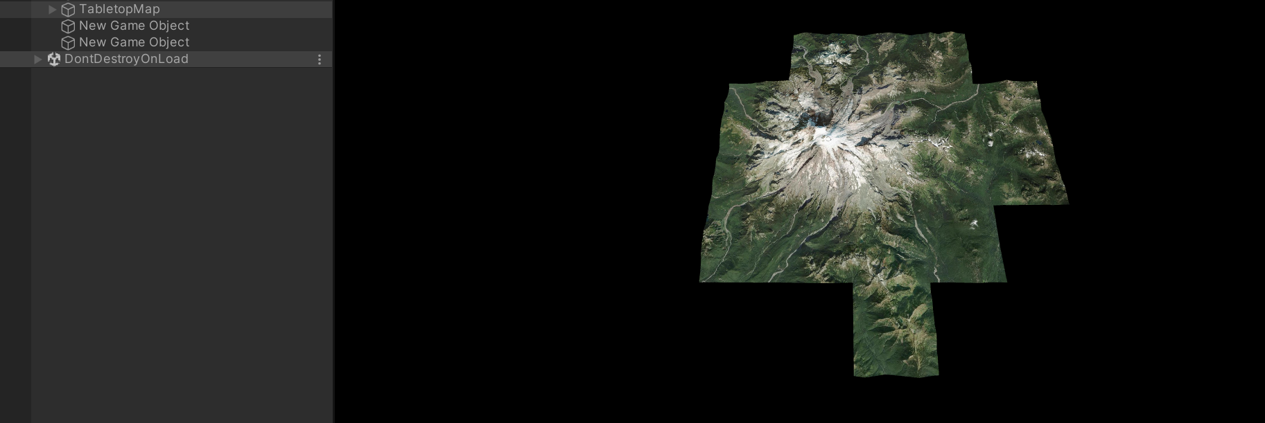

I'm trying to create a tabletop map for a Quest Pro app in Unity 2021.3.24f. Inserting a tabletop map prefab into the scene seems to only render the center tiles. Doesn't seem to be specific to whether the map extent shape is circular, square, or rectangular. Could someone help me troubleshoot what might be happening? I'm able to get a circular map on a desktop version of the app.

Hi Geoffrey, thank you for reaching out.
Can you please share your Map component properties? It also would be helpful to see the properties of the Tabletop component as well.
Currently, only circular extents are supported for the tabletop components. Using square or rectangular with version 1.3 will not work by default.

Okay these all look correct.
This issue is most likely with the shaders that clip the map to the extent. I have seen a similar issue in an XR project where another plugin modified the clipping shaders and broke them.
Can you please try removing, then re-adding the ArcGIS Maps SDK plugin in your Oculus project?
Specifically-
Packages > ArcGIS Maps SDK for Unity > SDK > Resources > Shaders > AlphaClipping.hlsl
This is used to clip to the radius.
Packages > ArcGIS Maps SDK for Unity > SDK > Resources > Shaders > TileSurfaceCalculateAlphaClipping.shadersubgraph
and
Packages > ArcGIS Maps SDK for Unity > SDK > Resources > Shaders > SceneNodeSurfaceImpl.shadersubgraph
use this shader code for clipping. If any of these have been modified, it may be causing this issue.

Hi Geoffrey. I created a scene with a tabletop map and deployed it to a Meta Quest 2. I was unable to reproduce the issue you shared. I have additional questions for you:
- What texture compression are you using? (I used ETC2, haven't tested others yet)
- Are you moving the map? Are you modifying the center or radius during runtime?

Hi @ZackAllen , I was also able to create a scene with the tabletop map on a blank project and deploy to a Quest headset. Yes, the center and radius are changed at runtime but I didn't see any issues on this new from-scratch project. I use ETC2 compression. But when I do the same in our active Unity project (same editor version, and project settings) I get that partially rendered map. You'd mentioned that it might be due to a different plugin interfering. If that is the case, is there a way to check what might be interfering?
