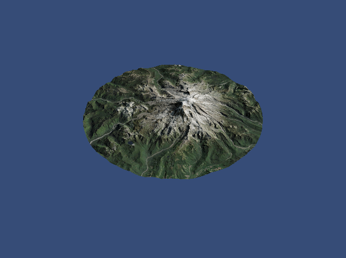

If these three conditions do converge, however, some weird stuff starts happening. The existing terrain tiles stay fixed in their current positions while the map pans over them (creating an effect similar to moving a spotlight across the map), and any new terrain tiles that spawn in do so at the edge of the map and stay there.

You should see the "moving spotlight" effect as the map extent circle slides across the screen, followed by all the new terrain tiles piling up at the edge of the map.
