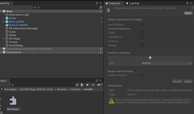

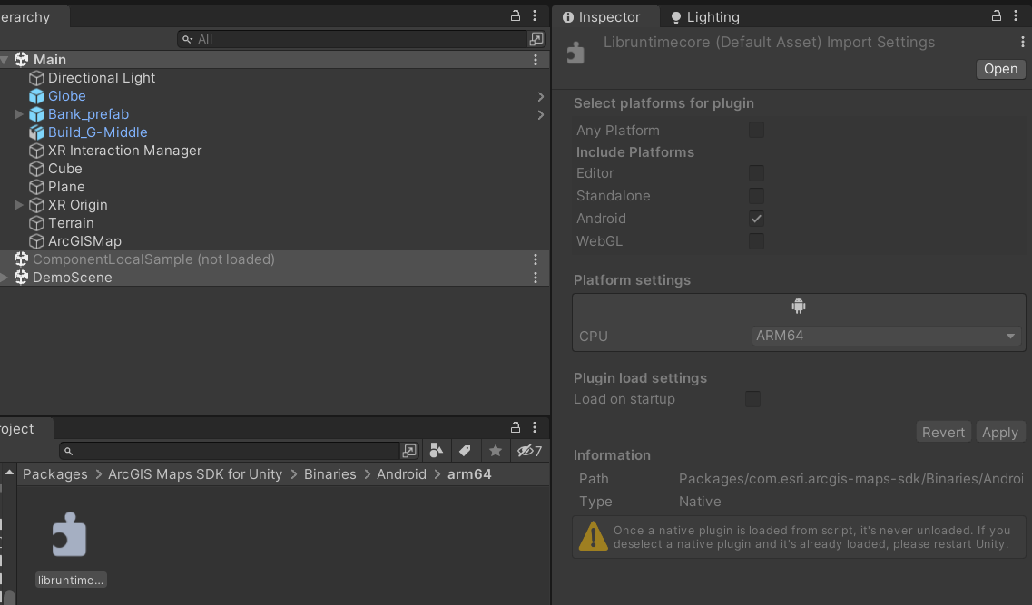

When I look into the actual package I see

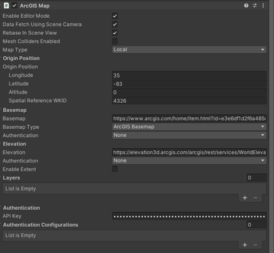

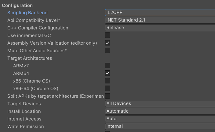

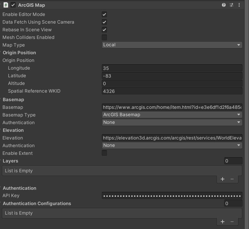

Is this not sufficient if I want to pull my own maps created from the ERSI website at runtime or will I need to make some ubuntu custom thing? I'm set up for an android build  intending to deploy to oculus. My configuration settings within unity are

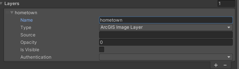

do I need any other configuration settings to pull maps created at the ERSI apart from the API Key? I'm attempting to pull these latitude and longitude coordinates from a map I created already. And am I having a bit of trouble:

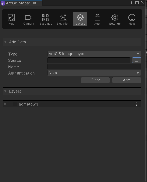

figuring out what goes in
I assume it mirrors the file creation within the Ersi site.
I assume I can reference my file here:
I appreciate any vector you can give me.
Is the reason I am unable to add the maps I've created to the API source  because I'm using the trial version. Do I have to have the pay versions to interact with the Unity game engine?

Yes, you need to build openSSL https://developers.arcgis.com/unity/reference/building-openssl/
Your config settings look good. There are other system settings that you might already adjusted which are all listed in https://developers.arcgis.com/unity/deployment/
Our plugin is free to use. Please refer to https://developers.arcgis.com/unity/layers/ for adding data.
