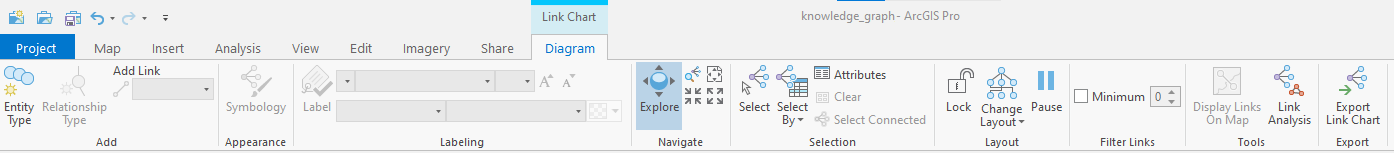

Link Chart 1:  The link chart created from right clicking knowledge graph in the investigation.
                         This link chart is a like a new map owning its window.
It has the following tools

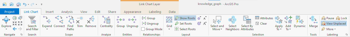

    (Link chart 2) The ordinary link chart created by Insert from a map -> "New Link Chart"
This link chart is under the current map. It has the following tool
 It has the "Display Links On Map" tool to show the relationship on map. (feature 1)
It also have the "Add link" tool for me to manually add link in the link graph  (feature2)

However, these two features 1,2 is not available in link chart1 generated by Knowledge graph.

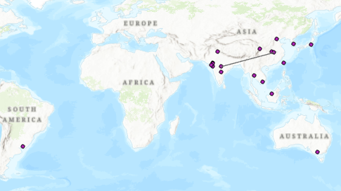

For our Knowledge graph based link charts, you can visualize the links between spatial entities by using the "Geographic" layout option in the link charts. Note this will also put 'nonspatial' entities in this map view.
