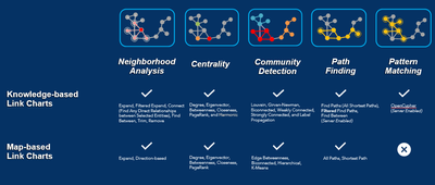

There are other differences in the selection tools, and kinds of link and graph analytics that can be done on each as well, as summarized in the graph below.
