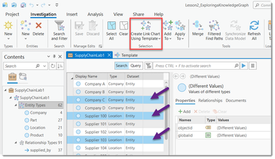

Specifically when it comes to Knowledge Graphs we are working on a way to more easily save and reuse symbology and labels for Entity/Relationship Types across Maps and Link Charts by allowing users to set a default styles for a knowledge graph that will travel with the service to each new visualization on a desktop or web client.
Today there are some workflows where you can set up styles in a "Template" link chart, if you will, and then when every you select Entities and Relationships, you can create a new link chart using the style of that Template.
