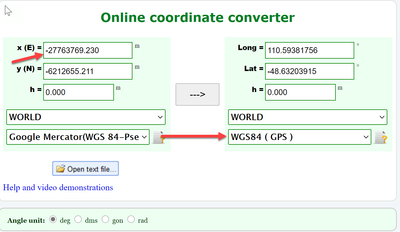

I'm getting the same response from https://tool-online.com/en/coordinate-converter.php#

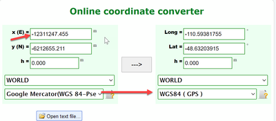

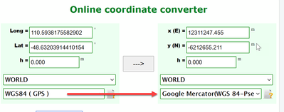

here are the images for various combinations from there.
coord_convert3.pngcoord_convert3.pngcoord_convert2.pngcoord_convert2.pngcoord_convert1.pngcoord_convert1.pngcoord_convert0.pngcoord_convert0.png
so assuming this is correct... and you have checked your inputs
