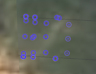

colorLocked property in the following CIM Symbol is not working in a SceneView if the feature layer has visualVariables active.
Symbol:
    const cimSymbol = {
        type: 'CIMPointSymbol',
        symbolLayers: [
                type: 'CIMPictureMarker',
                enable: true,
                anchorPoint: {
                    x: 0,
                    y: 0,
                anchorPointUnits: 'Relative',
                scaleX: 1,
                url: imageUrl,
                colorLocked: true,
                tintColor: [
                    255,
                    255,
                    255,
                    255,
MapView - 2D:
SceneView - 3D:

Hi @LuisSolaRuiz - this seems like a bug. Thanks for letting us know, we'll look into it.
