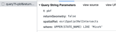

Do you have a reproducible case for this? I am not able to reproduce what you are describing here. I tested it and the following code
document.getElementById("queryButton").addEventListener("click", ()=> {
  const where = "UPPER(STATE_NAME) LIKE 'Miss%'"
  featureLayer.queryFeatures({where: where}).then((results)=>{
    console.log(results)
results in this query.
Screenshot 2023-03-07 at 12.06.43 PM.pngScreenshot 2023-03-07 at 12.06.43 PM.png
