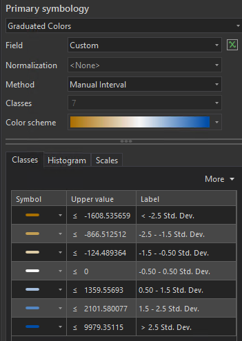

I have a polyline feature layer and I would like to represent this layer using the equivalent of Standard Deviation in ArcGIS Pro.
I tried using class breaks as the renderer but this does not seem to work for line features.
Is there a way I can replicate this symbology in my JSAPI code?
Thanks very much for any assistance.
