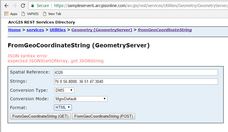

I tried right in the Geometry Service and got this
jaykapalczynski
Honored Contributor
I added [ ] in the geometry service and it worked....so looks like the string I am passing it...trying to add [ ] now
Nope...tried this and still no go

jaykapalczynski
Honored Contributor
I tried to create an array from the string and got the below error:
Entering Coordinates into input boxes as such:
76 0 51.2
36 25 47.25
error:
Error: Unable to complete operation
