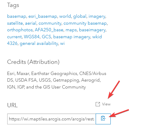

This item is NOT a VectorTileLayer: https://www.arcgis.com/home/item.html?id=898f58f2ee824b3c97bae0698563a4b3
If you scroll down on the description page, you will see the URL to the service:
Screen Shot 2022-02-22 at 12.02.26 PM.pngScreen Shot 2022-02-22 at 12.02.26 PM.png
As you can see this a cached map service and you need to use TileLayer to add this your map.
const tiledLayer = new TileLayer({
  url: "https://wi.maptiles.arcgis.com/arcgis/rest/services/World_Imagery/MapServer"

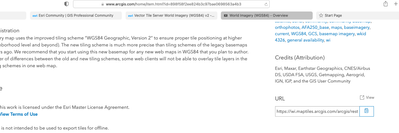

What I meant by url is broken is that when I tried to put the link for World Imagery into the browser it would give me a 404 error,
"The requested URL /ssldir/rest/services/World_Imagery/MapServer was not found on this server."
