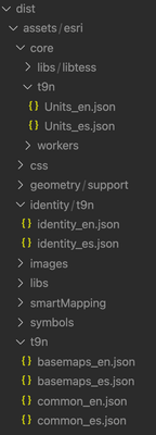

This strangely didn't work.. I was able to add the plugin and it's recognized, but the translation chunks still show up.. Do you have any other ideas?

I set up my project the same like yours, it's on Angular 13 though (shouldn't make a difference).
Could you please try with this and check what chunks are produced?
