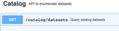

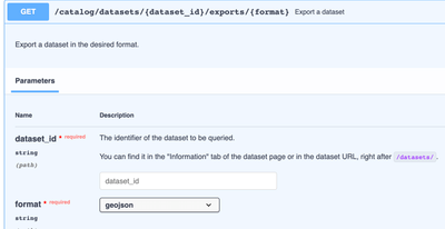

This one is going to require a little bit of work to find what data you want, but can be done. Looking at the opendata console, you can request results as geojson and use the GeoJSONLayer.
I think you would first want to pull in the datasets you are interested in. The API supports where clauses and other SQL queries, so you can limit to what you are interested in.
Once you do that, you can grab. a dataset_id. I'm not familiar with this, but they look like long strings with domains maybe?
Not sure that's what you're looking for, but it gets you to the next step.
This will give you the URL you can use to download the data in GeoJSON.
