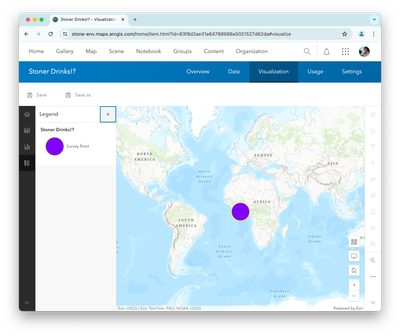

Consider this in the Visualization tab:
Screenshot 2024-06-14 at 3.44.59 PM.pngScreenshot 2024-06-14 at 3.44.59 PM.png

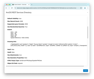

And this is what the ReST endpoint says for the drawing info (renderer):
Screenshot 2024-06-14 at 3.45.20 PM.pngScreenshot 2024-06-14 at 3.45.20 PM.png
They are not the same and I know (since i changed it a few hours ago) the "Visualization" tab is the most recently changed.
So, needing to pull symbology settings from the Visualization tab is because we need to avoid this disconnect.
